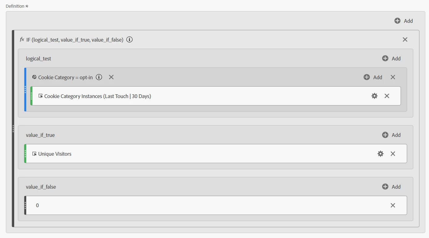

So this solution might seem a bit crazy.. but you have 2 values "opt-in" and "opt-out", and the user can change their value at any time.. so if you want to pull back UVs where the last value collected was "opt-in", you can do so with a calculated metric:
Using the IF function, you can use custom attribution on the "eVarX Instance" for "Last Touch | 30 Days" (or whatever period you need)
and a segment looking at eVarX equals "opt-in", if true, then return UVs metric, otherwise, return a static value of 0:

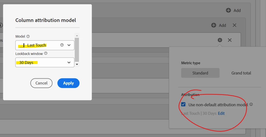

You can change the attribution of the metric here by clicking on the gear:
This way you can get the last touch for a specific value (i.e. opt-in)

Thank you for your reply! I successfully replicated this technique and it will definitely come in handy. That being said, a segment would still be useful so that we can apply it to AAM audiences, etc. for compliance purposes. Do you know if expressing these visitors as a segment would be possible?
Jennifer_Dungan
July 18, 2023
Segments don't seem to have the same custom attribution modelling available inside them.. but you should be able to create a segment using your calculated metric?
