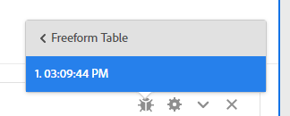

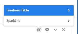

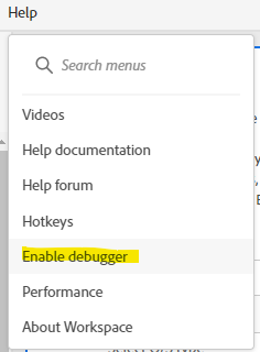

The "debug" method shared by Jen is the best way to learn about how to use Analytics API 2.0 by examples from Analytics Workspace.
