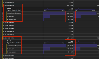

could narrow the traffic down by breaking it down by domain. It is a pattern that happens every 6h, with the same domains involved to almost exactly the same percentage
  1. echosignawsdevops.com ~75%
  2. azure.com ~22.5%
  3. microsoft.com ~2.5%

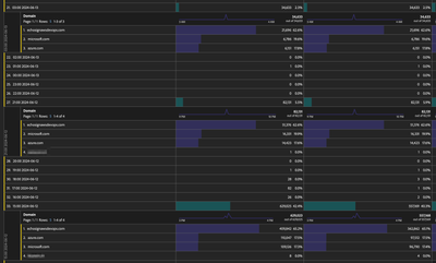

It goest up to 600k requests in a single hour. Insane. I would love to know who's generating these requests to yell at them 😄
