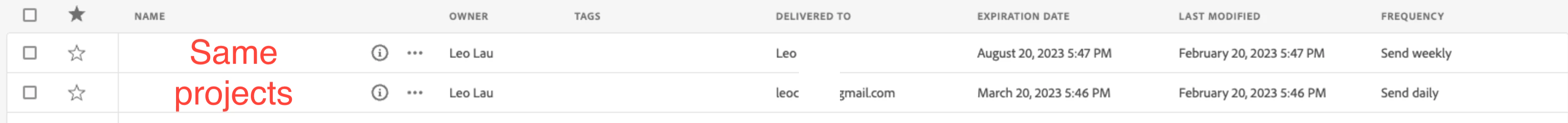

Would like to find out if it possible to have 2 different project delivery schedule & to different list of recipient using the same Analysis workspace project?
Best answer by leocwlau
Yes, you can. Every time you create a new schedule using the "Share" -> "Send file on schedule" will be a new schedule that can have different scheduling and recipients.
leocwlau
leocwlauCommunity Advisor and Adobe ChampionAccepted solution
February 20, 2023
Jennifer_Dungan
February 20, 2023
Just to add to this.. this is why when you want to add someone to an existing schedule, always do so from the Scheduled Project area; not from the Workspace itself... otherwise you will create multiple schedules that need to be maintained (someone in my organization did that, then had to come to me when they started getting 4 copies of the report - also, they didn't realize that they didn't need to reschedule when they made changes to the project)
