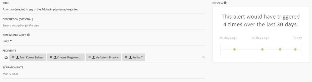

if you open the alert again, what do you see in the preview picture (alerts for the past)?
maybe you can send a screenshot of the alert so we can have a closer look at your settings...

Hi Thanks for the reply.
please find the screenshots of the anomaly rule created.

would do it the same way. either the lookback is wrong (which might be) or the alert doesn't work!
what I would do
1) setup an additional alert with a higher threshold so you get more alerts. this way you can check if alert fires or not
2) setup a workspace table with exact the same conditions (segment and metric as column head) and breakdown by days. can you see any anomalities (watch cells if anomality detection shows any alerts for single days)
3) check if you have enabled "anomality detection" in your permissions. might be a reason why you won't get any alerts...
