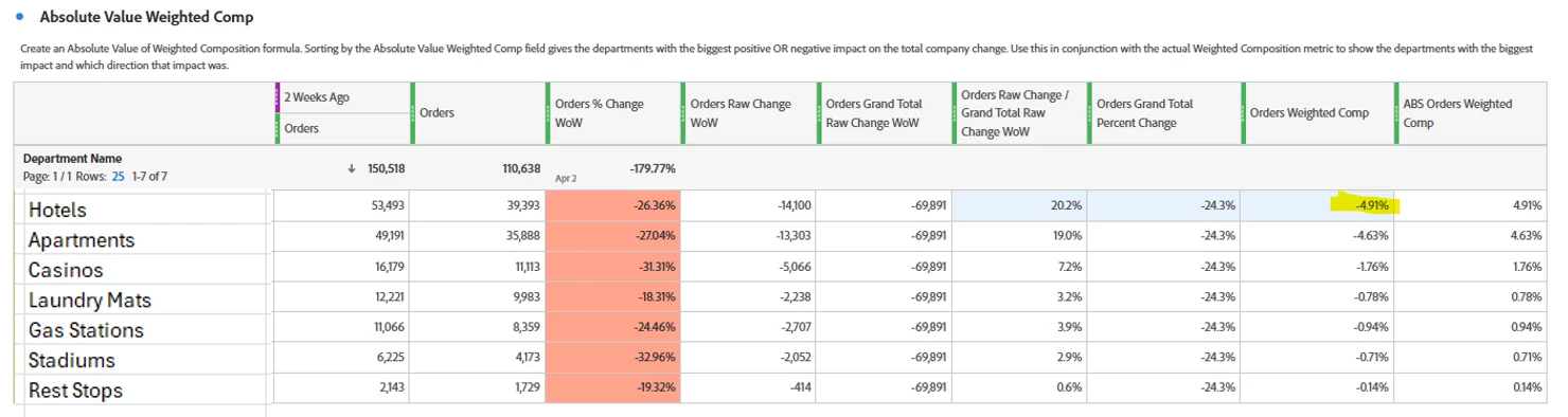

Hi there, I'm trying to set up an alert that will trigger based on a weighted composition value that is computed. I will include a screenshot of the math using orders, but my use case is looking at total null searches WoW and assigning a weight to how much a specific search term influenced total null searches WoW. As a result, sorting by this weight would show the null searches that should be fixed first and are influencing total null searches the most.
The math below says orders for hotels decreased -14,100 WoW vs all departments -68,891 WoW. As a result the decrease in hotel orders is 20.2% of the total decrease. Given all departments decreased -24.3% WoW, hotels made up -4.91% of the total decrease.
This would easily translate to null searches where if null searches went up by X%, we'd want to deal with the top Y that are greatly influencing this total number X.
I'm confused how to set up an alert for the highlighted column below that will say if any department (or search) is over Y%, send an alert so that it can be fixed.

Setting up and alert based on a calculated metric is possible, and you can specify what the threshold is...
I have a "Reload Rate" calculated metric:
and then I created an hourly alert for it:
Now, in my alert, I also have segments applied (I look only at Articles, and not any page on the site, and I set up multiple alerts... one for web and one for mobile apps).
In your case, you would need to set up a separate alert for each Department. So you would need to create a segment for "Hotels" and another for "Apartments" and so on... then make sure your Orders Weighted Comp is available in your components (and not just an ad hoc calculation).
Now, maybe I missed something, and you want your threshold to be calculated... that I don't think can be done, but maybe more of a changes by % might work for you?
This would compare the previous period to the current, if the change is more than 10% (in either direction) then send an alert.
You will just have to play to try and get something that works for you.

Thank you - I was worried it would have to be specified by department.... I was hoping to get around this because for the use case of null searches, the "department" will always be changing.
