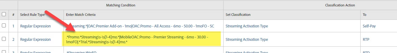

1. There is a classification rule created using a Regex, that sets one constant value as a result. Here is the expression:
.*Promo.*Streaming\s-\s[1-4]mo.*|MobileOAC:Promo - Premier Streaming - 6mo - 30.00 - 1moFO|.*Trial.*Streaming\s-\s[1-4]mo.*

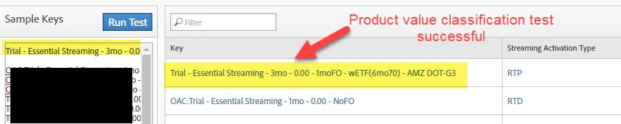

2. When running a test on the set of values, they are all classified as expected (screenshot 2). Here is a sample product value that passes the test:
Trial - Essential Streaming - 3mo - 0.00 - 1moFO - wETF(6mo70) - AMZ DOT-G3
3. However when looking at the reports, that particular sample product value (and many others) are listed under "Unspecified" and not with the right value.
