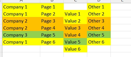

From all the investigation and conversations I've had and seen, this issue appears to be some sort of shifting of column data....
Even the so called "clean" data (where the data appears to be ours), is correlating incorrectly... values that only exist on our articles are showing on our home page URL for instance...
It appears to me that for the effected time of the issue, entire columns of data shifted up or down...
Basically something that looks like:
So if I was Company 2, my page 3 has someone else's value, and my page 4 has the value that should have been on my page 3...  However, none of us can see which fields shifted, in what direction, or how far they shifted...
Because of this, I currently don't trust any of the data for the affected period, letting my organization know, that data in the time frame isn't currently trustworthy.
