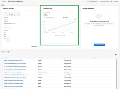

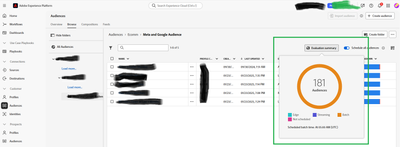

1. Refer "Evaluation Summary" from Audience tab,
2. Refer Audience detail page
3. Refer streaming segmentation guide for more details if the above one are not helpful - https://experienceleague.adobe.com/en/docs/experience-platform/segmentation/methods/streaming-segmentation

Here the Evaluation Summary will give only the count of Segments, that comes under what type of segmentation, hence this will not solve my ask.
And, the graph I am not getting in the UI, and I believe this is why because I have created me segment in the UAT environment?
Hence I am looking some API or may be UI feature that can help me to understand the last evaluation time or may be number of evaluation for my streaming segment in order to check if my segment is working as expected or not.
