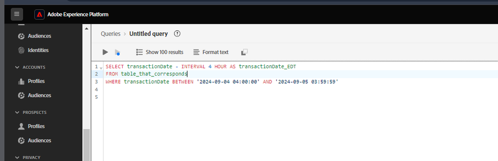

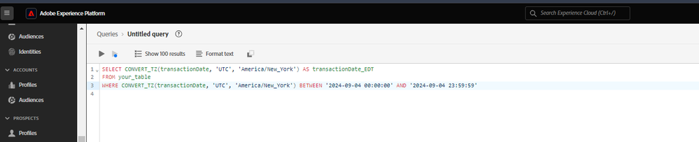

Hey @ccg1706 one more syntax question for you. Do you know how to convert the timestamp in a query from UTC to EDT? We noticed that running a query for previous days transactions data resulted in the query ending at 8pm EDT because the query in AEP is in UTC.
Hi @RyanMoravick,
Try with the mySQL CONVERT_TZ function. Sometimes it does not work cause it goes a little crazy, you can do it manually by substracting the differences between timezones. I share with you the two screenshots of the syntax.
Some documentation regarding the function:
MySQL :: MySQL 8.4 Reference Manual :: 14.7 Date and Time Functions
Hope it is useful, and if you need something more just let me know.
Celia
