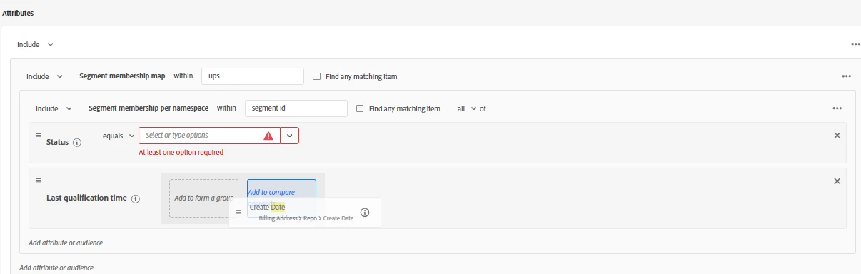

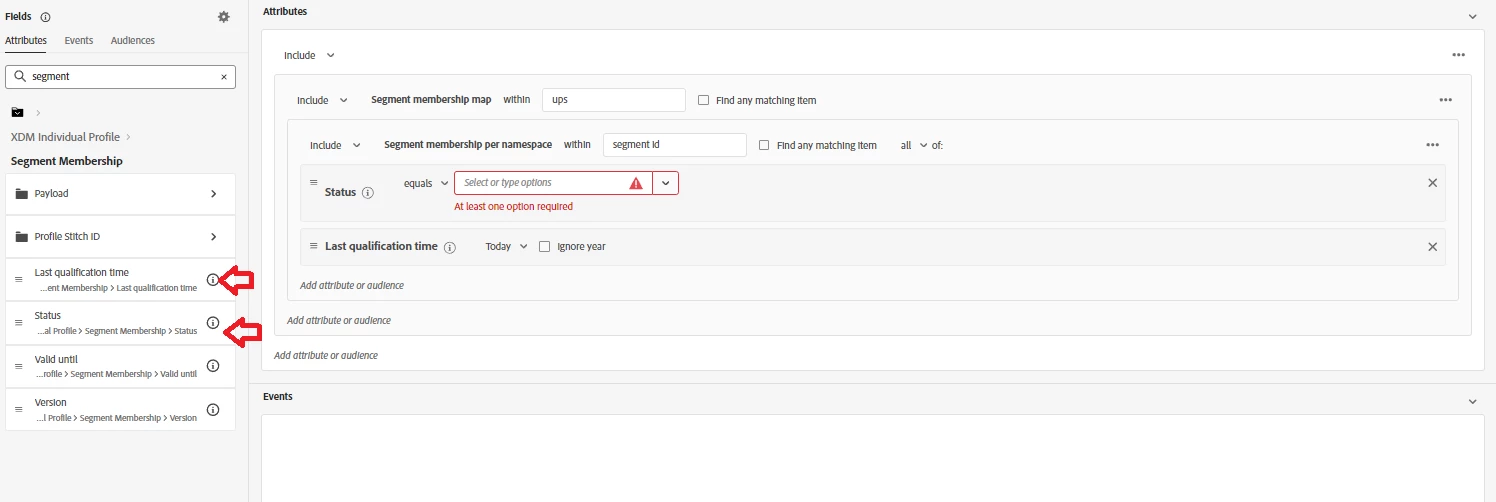

Hi all,
Is there a way to compare if the current date (date of audience eval) is less than an imported date field in an AEP audience? We have a requirement for this, and I'm not sure how to approach it.
Best answer by nnakirikanti
@trojan_horse This is possible, check the screenshot where you need drop these two fields in same upper container of "segment membership per namspace" container along with compare field to get required audience.
Note: "Segment membership map" should contain "ups" as string and segment membership per namspace should contain the audience id.
#1 Depicts addition of Segmentation status and las qualified time
#2 Depicts dragging attribute for comparison.
I hope this solves your need.
~cheers,
NN

Hi @trojan_horse
Could you potentially give a basic example of what this data your trying to compare would look like?
David
nnakirikanti
nnakirikantiCommunity AdvisorAccepted solution
June 11, 2024
~cheers,
NN
