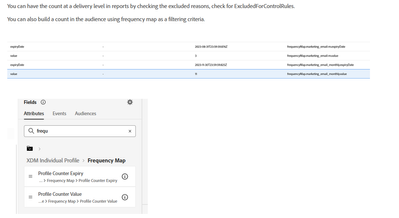

When using daily frequency capping, the cap resets at 00:00:00 UTC each day, as the cap is valid until 23:59:59 UTC. From documentation,
https://experienceleague.adobe.com/en/docs/journey-optimizer/using/conflict-prioritization/capping-rules/channel-capping
"Daily - The daily frequency cap is valid for the day until 23:59:59 UTC and resets to 0 at the start of the next day."
Frequency capping is applied during the email delivery preparation phase, and the exclusion reason is recorded on the profile level. To re-attempt sending the email, you can create an audience that excludes profiles with the specific exclusion reason code and retry the send after a day.
For details on exclusion reason codes, refer to the following documentation:
https://experienceleague.adobe.com/en/docs/journey-optimizer/using/reporting/channel-report/exclusion-list

the capping for frequency is reset daily and is available at profile level or in the message feedback dataset as the exclusion happens at the message authoring level.
your logic of wait an hour may not work because of the latency and time of evaluation vs send but you need to create a batch audience and extend your wait to a day (instead of an hour)

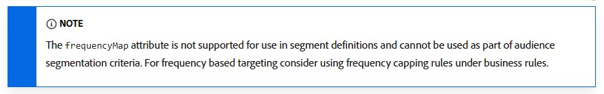

As mentioned, you need to review your logic as it's not possible as is.
frequencyMap is not supported in segmentation and the message feedback table can be leveraged only in batch segmentation. You will need at least a day of wait but also this can be an issue depending on your evaluation time etc.
if this email is really important I will suggest to not add the business rules for it.
