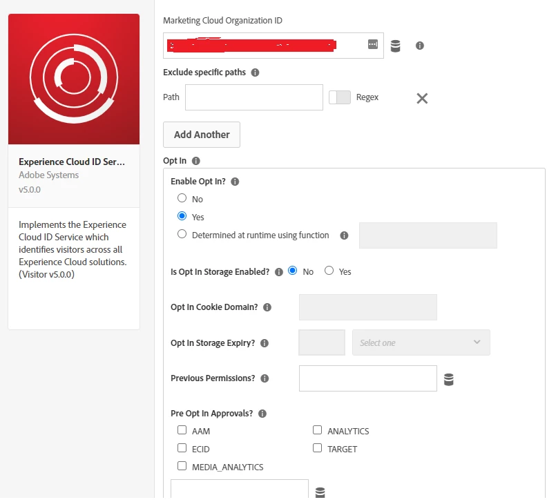

Can't see any delivery request in network tab and experience not pulling through target - opt in service
We've implemented opt in service using Adobe Launch. Configured the ECID extension correctly like below
Now once the user accepts cookies for target, we've update the permission and invoke direct call rule to trigger as permission/ consent provided.
adobe.optIn.approve(adobe.OptInCategories.TARGET, true);
adobe.optIn.complete();
Can see Adobe request coming through on page
but can't see any delivery request in network tab instead getting below warning in console  and experience not coming through target
Any idea what's wrong here?

shelly-goel
Dec 22, 2020 12:41 AM UTC
@gokul_agiwal
Please set 'Is Opt In storage enabled' to 'Yes' (Launch > EC ID service extension) so as to store the opt in permissions in a first party cookie 'adobeujs-optin'. You can also debug in the browser console to see 'adobe.optIn.permissions' returns the expected result of each category or not.

Gokul_Agiwal
Dec 22, 2020 12:01 PM UTC
@shelly-goel
Thanks for the response. I've had check I can see the correct values return by 'adobe.optIn.permissions' for each category like below  but it can also shows the warning message
where as when I interacted with my cookie banner and select only allow Target cookies then with my earlier implementation (in question)  works correctly and I can see the experience through target  and interestingly can't see the above target warning
Not sure why this happening? Any idea?
Help appreciated, Thanks
