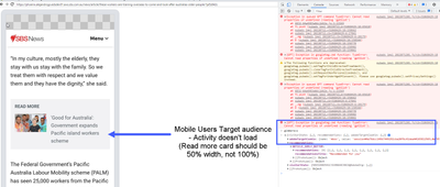

I have a web A/B test with two experiences. I want to target only Mobile Visitors.

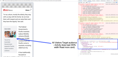

The variant B experience loads correctly on desktops and mobile phones/device when the Audience is set to All visitors.
But when using a Target Audience Is Mobile Device "true" OR Is Mobile Phone "true", the variant B experience does not load on any device (mobile or desktop).
I can visually see the experience doesn't load, and also debugged in the console when USB debugging my mobile phone plugged into the computer.
Why doesn't the experience load when using this audience?
