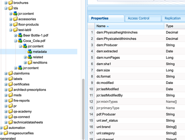

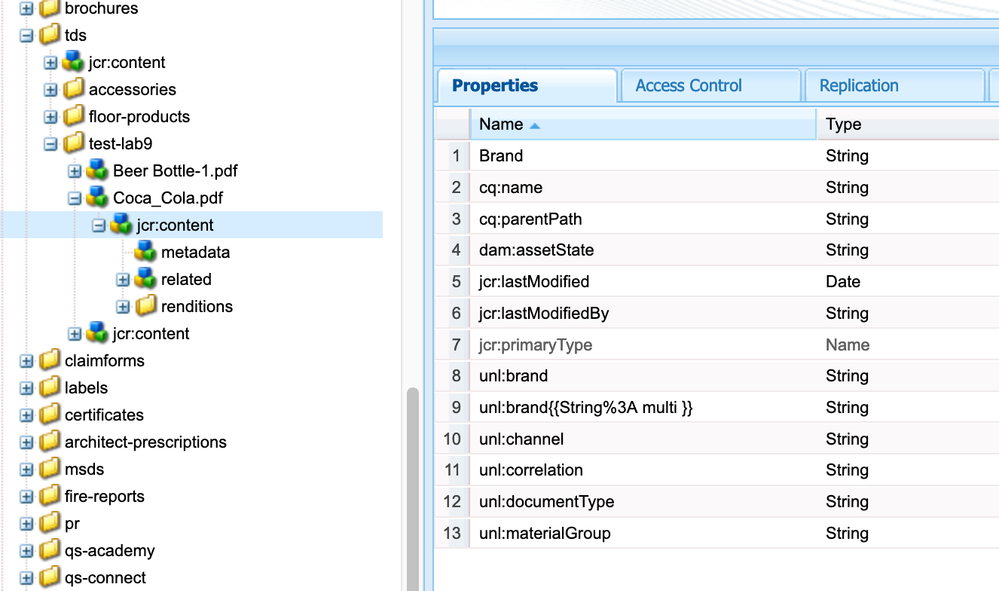

I checked inside CRX and I found that I need to do create my request like this:
"class": "asset",
"properties": {
"metadata/unl:documentType": "TDS",
Looking in CRX I see metadata fields which are defined in "metadata" and in "jcr:content". Is it possible to explain this division?
Are custom fields always in "metadata"?
Is it safe to update the metadata in both locations?

hi @jonasy18481676 ,
Sync metadata update between dc and jcr namespace - you have to do this sync after updating metadata using api call.
The API method updates the metadata properties in the jcr namespace. The updates made using the user interface change the metadata properties in the dc namespace. To sync the metadata values between dc and jcr namespace, you can create a workflow and configure Experience Manager to execute the workflow upon asset edit. Use an ECMA script to sync the required metadata properties. The following sample script synchronizes the title string between dc:title and jcr:title.
Check this for more details,
https://experienceleague.adobe.com/docs/experience-manager-65/assets/extending/mac-api-assets.html?lang=en#update-asset-metadata
