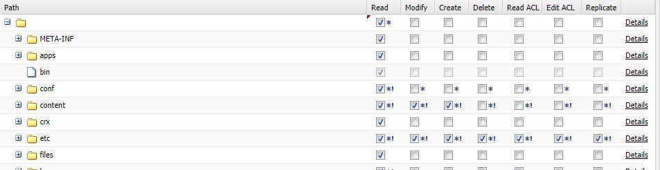

some where in code login user is trying to access root node
for eg: Node root = session.getRootNode();
To check login in  as http://localhost:4502/useradmin
relative path as : /useradmin
below is the example of without root node access permission : see the first line in the folder path no root access
for this logged in user provide at least read access permission as below :
