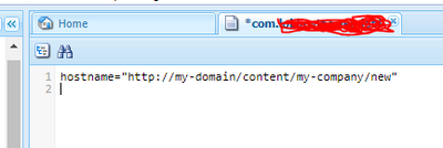

We are facing an issue where OSGI configuration values are not getting updated when we check in the /system/console/ConfigMgr
For Ex:
If we make changes in the config file and deploy the same it reflects correctly in crx/de But not in /system/console/ConfigMgr.
We still see old value and have to manually make the changes.
We have taken care of run modes as well so that they should reflect the respective values.

As I am reading OSGi configuration in above scheduler so, PID is pointing to Scheduler Class itself as shown below -
I have deployed everything on local AEM author instance and every time I am modifying contentpath in CRXDE here /apps/demo/osgiconfig/config.author/com.aem.demo.core.schedulers.ResourceExpirationScheduler.config and change is getting reflected in config manager /system/console/configMgr.
My sample OSGi configurations is getting stored in file system under following path
C:\Users\debal\AEM-instances\demo-author\crx-quickstart\launchpad\config\com\aem\demo\core\schedulers here -
If we take close look this path is nothing but
<AEM-instance-installed-directory>/crx-quickstart/launchpad/config/PID

We had similar issue in our project. If you are having OSGi configuration structure like the below one -
Then please check config file[PID] under relevant config folder like config.author or config.publish or config.stage which is aligned with the run mode of that AEM instance and make necessary changes in that config file[PID].

Are you creating your configurations as "sling:OsgiConfig" node . I am not seeing anything in crxde like below
<jcr:root xmlns:sling="http://sling.apache.org/jcr/sling/1.0" xmlns:jcr="http://www.jcp.org/jcr/1.0"
jcr:primaryType="sling:OsgiConfig"
Check this configuration for reference /apps/weretail/config/org.apache.sling.serviceusermapping.impl.ServiceUserMapperImpl.amended-we-retail
