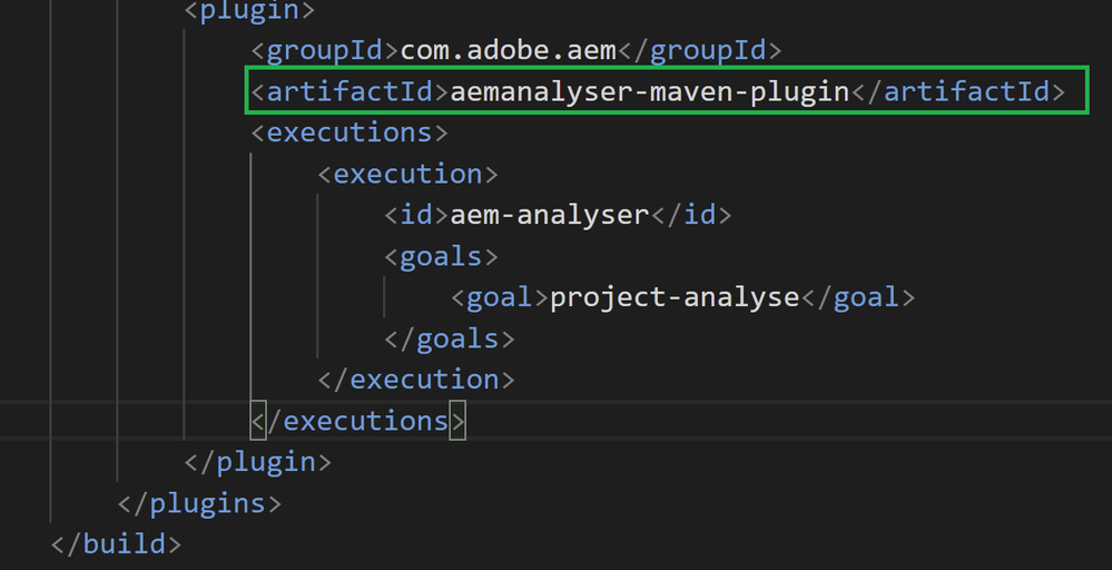

Best answer by Vijayalakshmi_S
@codingstar
This is because of the aemanalyser-maven-plugin that gets executed in all module of the project which run the same checks locally as in the Cloud Manager deployment pipeline.
More about the plugin : https://github.com/adobe/aemanalyser-maven-plugin/blob/main/aemanalyser-maven-plugin/README.md

@codingstar
For the reported analyzer error,
Whole list of analyzers that are executed as part of this plugin : https://experienceleague.adobe.com/docs/experience-manager-core-components/using/developing/archetype/build-analyzer-maven-plugin.html?lang=en
