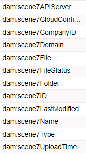

If above everything is in place then upload a sample asset and check whether the Scene7 metadata is updated for that node:
<Asset_Path>/jcr:content/metadata and you will find below properties:
Hope this helps!
