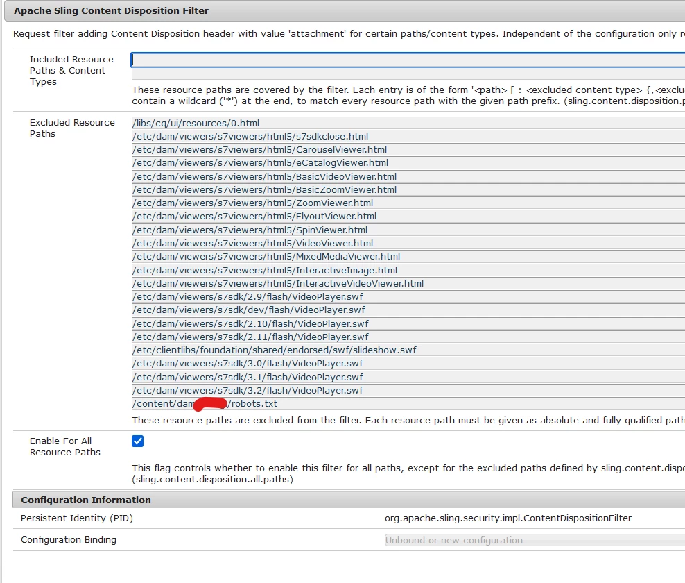

I have couple of queries regarding the Apache Content Disposition Filter -
1. I have a robots.txt file in /content/dam/abc/robots.txt location.
I have added the same in Excluded Resource Paths as shown below -
When the "Enable For All Resource Paths" is checked/enabled the robots.txt is downloading even though the Excluded Resource Paths has the entry.
When the "Enable For All Resource Paths" is unchecked only then the robots.txt is displaying in browser.
Can anyone please explain why this behaving this way ?
Ideally the Enable for All Resource Paths should be checked and even then the file should open in browser.
2. What is the default value for Enable for All Resource Paths ? Should it be checked/unchecked in an ideal scenario ?

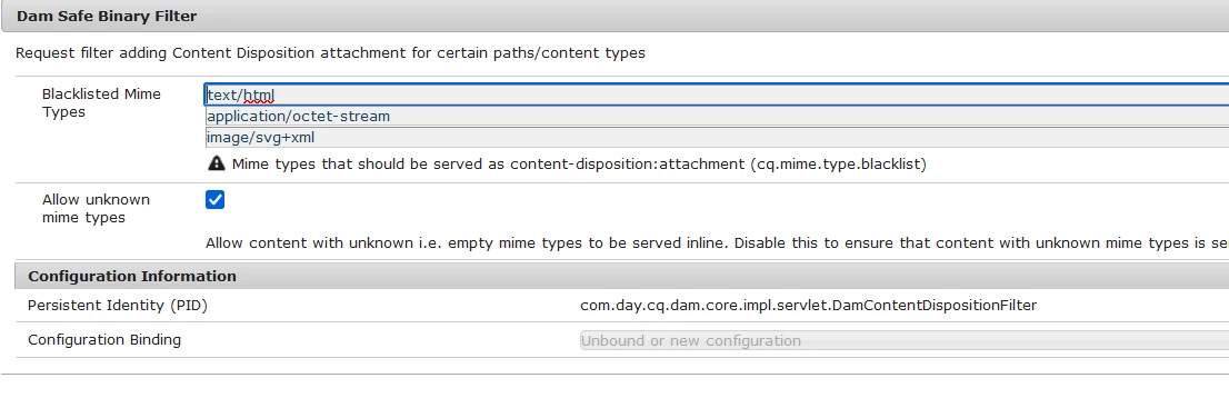

3. There is another configuration "DAM Safe Binary Filter" which adds content disposition attachment for certain paths/content types. It previously had the text/plain included in the blacklisted mime types. Even removing that did not solve the problem.

Thank you @arunpatidar, The redirection and header setting is already handled in dispatcher.
However, if we just look at it from publish instance's point of view can you help with why despite specifying the path in excluded resource path is the file still downloading when "Enabled for all resources" is checked.
