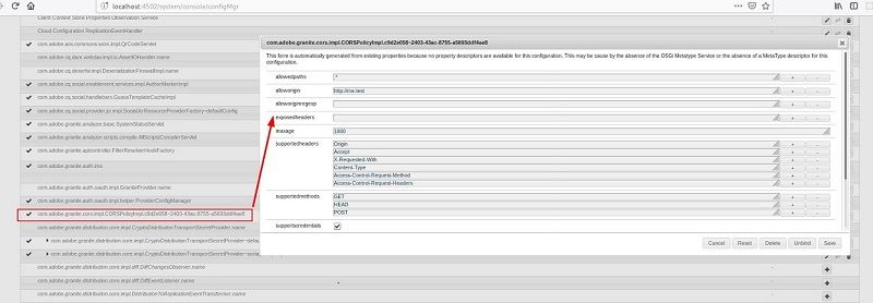

May 14, 2019 2:10 PM UTC
Hi JaideepBrar​,
sorry need to correct my initial description: The configuration worked so far for one added custom configuration, but it is displayed not right below the "Adobe Granite Cross-Origin Resource Sharing Policy" in the Felix Configuration view, which was a bit confusing.

May 14, 2019 2:37 PM UTC
As you can see JaideepBrar​ in my previous comment with the Screenshot, we used actually the same PID ("com.adobe.granite.cors.impl.CORSPolicyImpl.c9d2e058-2403-43ac-8755-a5693ddf4ae8")...that's why we are a bit confused....

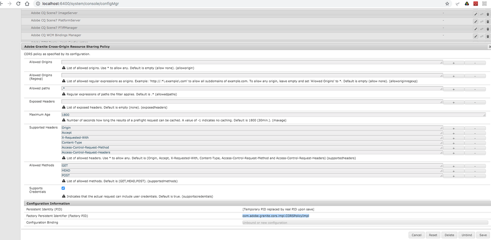

I tried editing the CORS configuration from /system/console/configMgr. Once i save the changes, noticed the following file getting created under crxde:
/apps/system/config/com.adobe.granite.cors.impl.CORSPolicyImpl-122113ad-1f51-4b73-9c4f-ba1c0d2f1395.config
Have you tried updating the configuration from /system/console/configMgr ?
In another test, I installed the copy-pasted the "com.adobe.granite.cors.impl.CORSPolicyImpl-122113ad-1f51-4b73-9c4f-ba1c0d2f1395.config" and changed the PID and can see the configs under CORS:
So, check the syntax as you should only be changing the PID number (122113ad-1f51-4b73-9c4f-ba1c0d2f1395) for example
