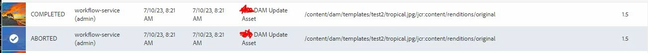

When I upload an asset (tropical.jpg) to the dam and the asset already exists in the dam and I select Keep in the UI Dialog: Duplicate Asset Detected the following trace is recorded in the error.log.
The image in Dam stays forever in status Processing...
There are two workflow status entries recorded in the Workflow Archive. One is Completed and one is Aborted.
Any suggestions what could be the cause and where should I troubleshoot?

July 11, 2023
hi @anasustic ,
Could you please explain the customization you did on AEM DAM Update asset workflow.
Also screenshot of step where it fails from UI.
Nikita Garg
