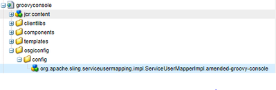

Hi @arunpatidar
I need to update the user.mapping value for the below path. Kindly share the best approach to do the same.
/apps/groovyconsole/osgiconfig/config/org.apache.sling.serviceusermapping.impl.ServiceUserMapperImpl.amended-groovy-console
current
aem-groovy-console-bundle=groovy-console-system-user
Expected
aem-groovy-console-bundle=[groovy-console-system-user]

Hi @arunpatidar thank you for the reply.
Its not a custom config file. The below path is under groovyconsole and its a package created through pom.xml.
And there is a need to update the user.mapping value to this.
current
Expected
Kindly suggest how to handle it.
Thank you

Meantime, I was trying to updating it through groovy script itself. But not its not returning the properties. But the issue here is its still showing as node instead of config file. Any help to resolve it please? Can't change it to config in higher environments as I don't have access.
import org.osgi.service.cm.ConfigurationAdmin
def admin = getService(ConfigurationAdmin)
def config = admin.getConfiguration("org.apache.sling.serviceusermapping.impl.ServiceUserMapperImpl.amended-groovy-console")
def properties = config.properties
def String[] mappings =(String[])properties.get("user.mapping") as List
mappings.add("aem-groovy-console-bundle=[groovy-console-system-user]")
properties.put("user.mapping", mappings.toArray(new String[0]))
config.update(properties)
Hi @Lakshmi99
You can update the node's property at /apps/groovyconsole/osgiconfig/config using jcr/sling api
