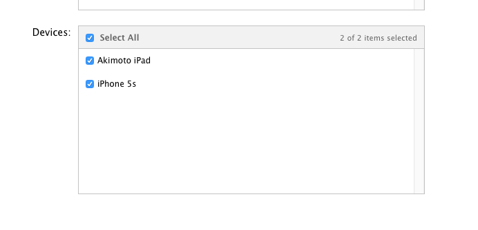

When I drop it on my iPad or iPhone it shows the application, but not the app icon. When i tap it to launch it says: installing. It don't install or launch or anything.
I have add the UDID to the mobile provision. I will try this again.
Thanks for the response!
Ah damn, it will not work
Does someone have an idea?
After you added the UDID, did you then edit the mobile provision file, download it, and use that mobile provision file to build the app? In some cases, people will add the UDID and then fail to include it in the mobile provision file or use the old mobile provision file.
You might also want to double-check your UDID, especially if you used a third-party tool to obtain it. Use iTunes or Xcode, and copy the UDID, not the serial number.
It could also be a mismatch between the mobile provision file and the .p12 certificate you used. You need to use the same p12 certificate you selected when building the mobile provision file.
Thank you very much! It was the wrong UDID. I did it with an app.
