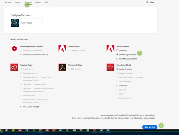

When Firing:
To obtain an access token, you now may notice the following error in the response:
‘’ Scopes from metascope are not a subset of the client id scopes ‘’
You must now do the following:
  1. log into console.adobe.io
  2. Edit configuration > Services > Adobe Services: Add I/O Management API > Add Service
Best answer by harishkumar
You can get the metascope link form the jwt tab in the integration. That should work. If you can share the jwt tab screenshot , I can let you know exact link that need to taken and used in the code for api integration.

harishkumar
harishkumarAccepted solution
January 30, 2020
