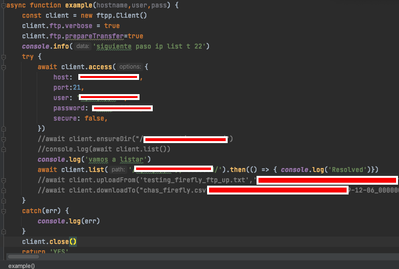

From adobe io runtime we are deploying an app. One of its functions is to take a certain document and upload it to FTP. The problem we are encountering is that as indicated in this link https://adobedocs.github.io/adobeio-runtime/resources/faq.html#what-ports-are-open, certain ports are not open, including port 21 which is the one with which I must access the FTP. How can we solve this problem? I am using the BASIF FTP client for Node.js.
This is a little fragment of the code:
The output is:
Thanks all!

The FTP we want to access is the Adobe customer attributes FTP. We are currently working on an automation that retrieves data from a third party tool(BigQuery) and loads it to Adobe Target. We should be able to automate the data upload that was done manually with an automated process at a Project Firefly application.
I see in this link https://experienceleague.adobe.com/docs/core-services/interface/customer-attributes/t-upload-attribu... that this resource can be accessed from both FTP and SFTP. In our tests, we have been able to execute the code in Node environment, but when moving the execution to Adobe i/o we are gettint multiple errors. AdobeIO runtime has port 21 blocked and Im not able to connect the FTP on port 22. Also with SFTP we have problems within adobe io runtime (like timout errors)

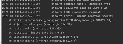

Right, if we connect to port 21 or 22 from a local Node.js environment we have no problem. Trying to connect to this FTP with port 22 from the Adobe IO runtime the output is a TIMEOUT:
