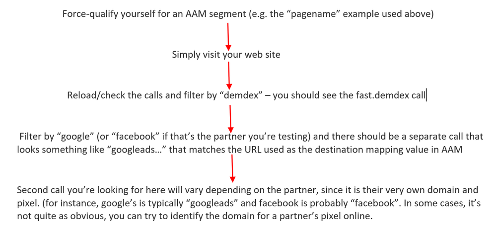

2. The other way to validate the URL destinations is to verify the network calls:
To validate that a pixel is properly firing on site:
