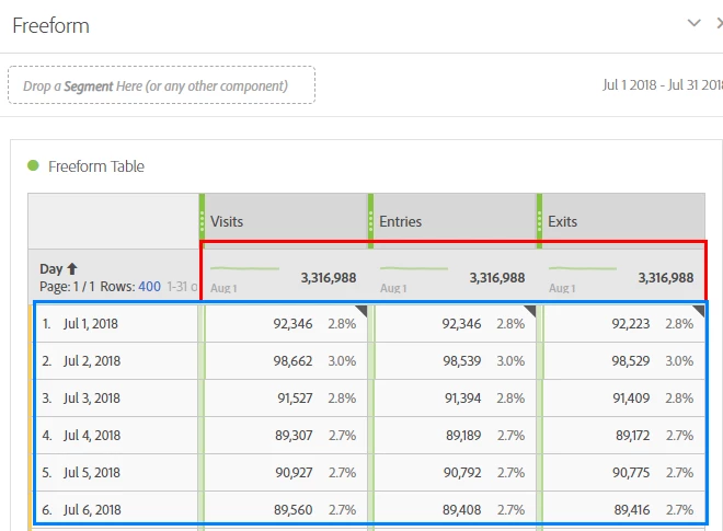

I narrowed the data from Jul 1 - Jul 31 and put the day in the dimension and placed visits, entries, and exits.

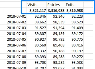

As you can see, the total number (red box) of each metric seems to be the same (3,316,988), however, when I copy-paste the numbers (blue box) on excel and sum it to compare,
the total number of each metric is different (visit > entry, exit)
Can anybody help me understand why this is happening? Thank you so so much in advance!

While every visit has an entry and exit, breakdowns may not. this is because of the time range you are looking at
For example, when looking at day dimension, I may have had a visit start on a particular day right before midnight, and then end on the next day.
  • The visit will be shown in both
  • The entry will be shown on day 1
  • The exit will be shown on day 2

hyderziaee is 100% correct here. The difference between those numbers are visits that span midnight.
