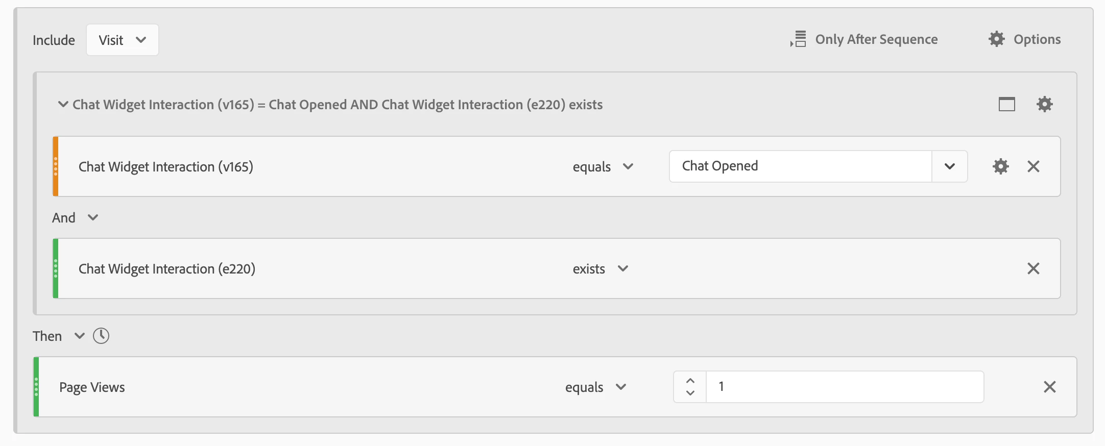

I'm trying to define a segment to get me the single hit after a particular event happens.  I've tried a number of combinations of sequential segments and exclusions but nothing seems to get just the one hit.
The question I'm trying to answer is:
What was the Page Type (v12 and p1) immediately after the customer interacted with the chatbot (event220)?
I've tried the following:
and also:
But these don't limit to just the one hit.
How do I get just the single hit?  Can I use something like Entry page - does that still work after a sequential segment?

You can't segment for a single hit. It's just... impractical in AA's sense. Analytics is usually about looking at trends and behaviours, and your requirement is too narrow for that.
@fredrambert's suggestion is your best option.

I'm trying to find the trend of what the page type is that people visit immediately after an event happens. But I want to know only the first value rather than all page types after the event.  I don't see how it is different to entry page, other than the event is a custom event rather than the visit start.

Right, we've solved this in Workspace using a flow visualisation and the evar that is set at the same time as the event fires:
(e220 fires to say chat interaction, and v165 has the details of what the interaction was)
Now for the real question... how to do this in Report Builder? 😄
I think I'm going to resort to "Create Segment from this path..." and build a segment for each page type. Luckily I'm only interested in five or six page types, not all of them...
