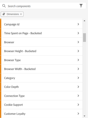

I have verified all the scenario and somehow data is getting PROD report Suite. But it doesn't look like any of the evars/props are populated in Workspace , the out of the box data is coming in .
Note : We dont have any access related issue. Have all required Permission.
This leads me to believe that those props and evars may not have been defined or on in prod.
Can you check in Admin section report suites, are the props and evars defined? and enabled as on?
