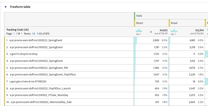

we are encountering an issue where a significant amount of traffic from email tracking code (starting with e) is moved heavily out of email and into direct and also paid search tracking code (starting with s)is moved into referrers. Nothing significant has changed on the site and was wondering was if anyone can shed light on why this could be happening.

URL structure for email site.com?ecid=e:pr:promo:eam:doff:mcl:050222_SpringEvent&mi_u=233715898&mi_ecmp=050222_SpringEvent&link=hero...
for Paid search its ?ecid=s:

This table showing example hits might illustrate what I'm saying:
| Tracking Code (v0) | Marketing Channel | |
| Mon 12:00pm: visits your site from a paid search link | s:one:thing (instance) | Paid Search |
| Tue 9:00am: visits your site from another paid search link | s:something:else (instance) | Paid Search |
| Thu 11:00pm: visits your site from a friend's website link | s:something:else (persist) | Referral |
