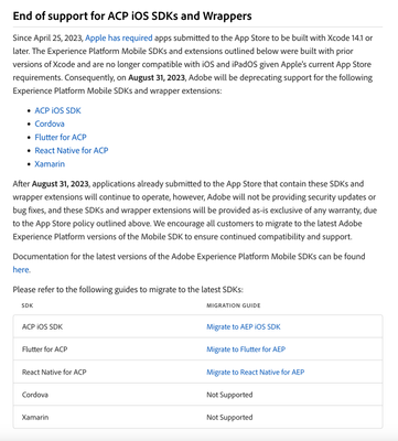

Also note that, Adobe is no longer supporting ACP iOS SDKs from August 31st 2023.
https://developer.adobe.com/client-sdks/resources/sdks-end-of-support/
