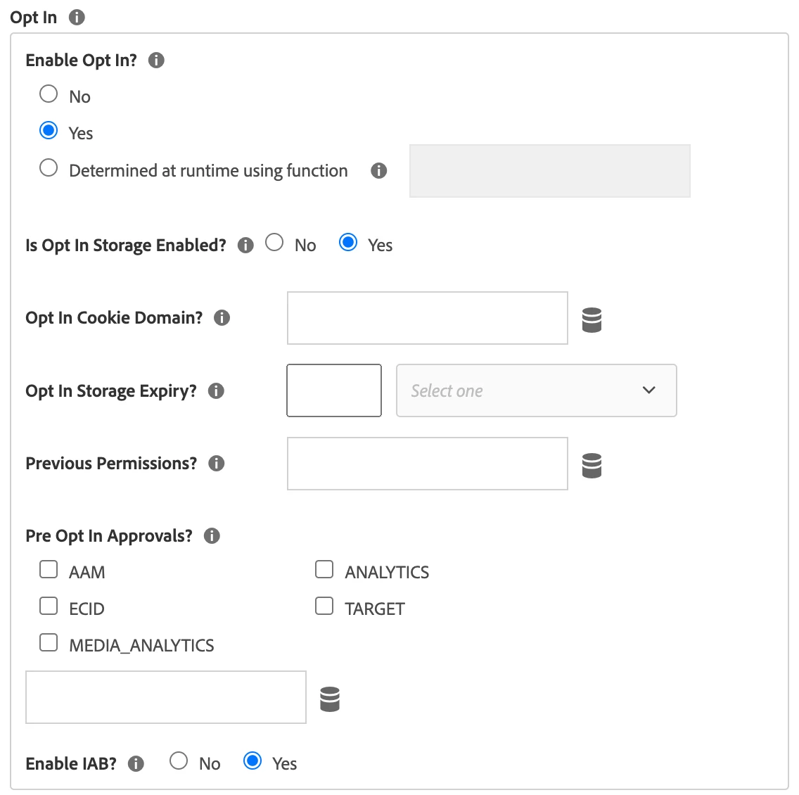

  • Visitor ID Service, configuration is
My problems/questions are now:

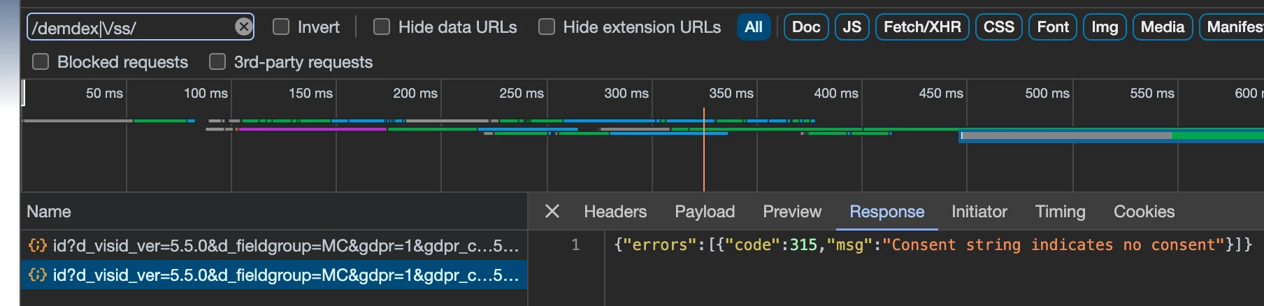

Looking at the demdex call's response after page reload, it actually says "no consents given" and documentation says "When no consent is provided, the Audience Manager Plug-in for IAB TCF opts the user out of further data collection, or drops the call completely if there is no partner context detected."
How can the Didomi IAB consent not be readable? Is it possible that some vendor mapping is wrong?

I see that you say you have "Opt In Storage Enabled", but I don't see where you are telling Adobe where to find that?
Here is a sample I was playing with, I don't have storage in my example, and I started with the "Opt Out" approach:, but then I set my "default" permissions to false manually in the "Previous Permissions"
So Technically, in this example, users were opted out (i.e. false). If I were doing this for real, I would use Data Elements to populate the previous permissions based on Data Elements pulling values from the site...  And IF I had storage enabled, I would expect that I would need to set those up as well, mind you, I think this is Adobe Storage, if you are reading from a vendor storage, you probably don't need that, you would just have to read and set the "Previous Permissions" from Data Elements pulling the values from what is managing consent.....

thanks for your response! Pre-approval for Adobe solutions is unfortunately not legal inside of the EU and Switzerland. Also, in your example you neither have "enable consent" nor "enable IAB" set which is essentially the issue I am having. I have set up the visitor ID service for many clients when it was simply just reading consent categories from a consent cookie, but applyig this IAB stuff is completely new to me. So I would assume I am missing something here.
What surprises me is that there is no Adobe documentation on this respectively, all I found is a video clip where it's being said that you enable consent, you enable IAB, optionally enable storage in a cookie (without setting anything else) and there you go.
What the "IAB" feature seems to come with is an API that can be used to read out the permissions from the consent string. Yet again, not a word on how that can or should be used.
