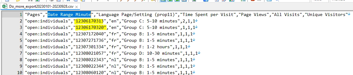

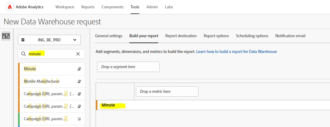

since last week a new UI is available for datawerhouse export in Adobe Analytics.
In this one now you can export the minute:
I tried an it works but not sure how to interpret this field: how can I make it easier to read:
I have to share it with some users and they expect to see it like in the workspace:
Maybe not exactly the same way but something readable.
Any suggestion?

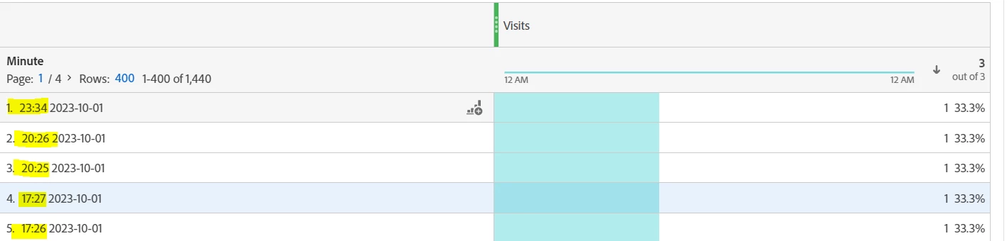

I did a test on my end by requesting a Data warehouse export with Month as dimension and Visit as Metric dated Oct,1.
Workspace:
Export:

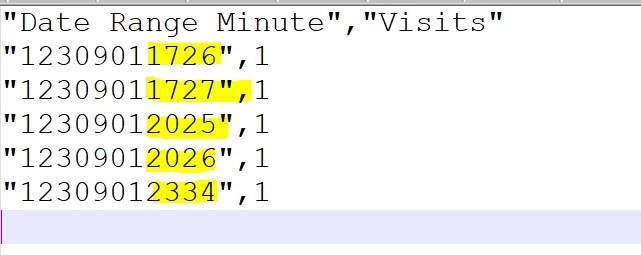

So, the minute exports in the following format: 1YYMMDDHHMM
where Month ranges from 0 to 11, 0- Jan, 1 - Feb ----- 11 - Dec

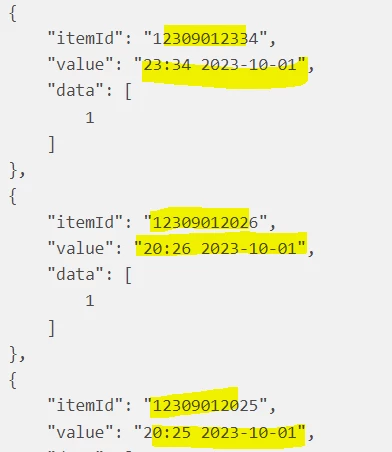

Moreover, I validated the syntax with the help of API.
API:
1st Oct, 23:34 comes up as 12309012334 (1YYMMDDHHMM) in the DW export.
Similarly, 29th Sept, 11:16 comes up as 12308291116 (1YYMMDDHHMM) in the DW export.
Workspace:
Export:
API:
