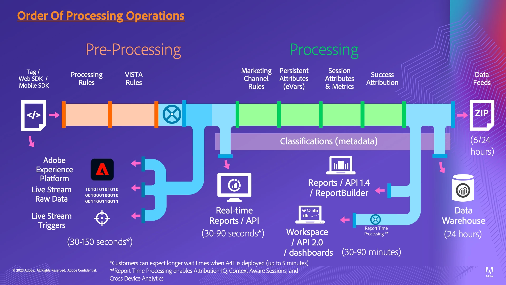

I have a site for which analytics is set up. I want to export a copy of the data that is being tracked and sent to the Data Hub/ Data Wearhouse.
I have a (SDR) that tells me the specifics of what data is being collected but I want to have an export of raw data (for about a quarter).
How can I access this?
Best answer by AbuSh1
You have many option to get data from Adobe analytics
1. Make a decision if you want pre-process data or post process data
Use this diagram to find out what is appropriate for your use case

@ykk360 - The different options shared above can be checked, and I believe the Data Feeds option would be suitable to export the raw data for your Analytics setup.
https://experienceleague.adobe.com/docs/analytics/export/analytics-data-feed/data-feed-overview.html?lang=en

Hey @ykk360  - It depends if you want to look at aggregated or hit level data - if you are looking for aggregated data, then you can use Data Warehouse to export the data but if you are looking for hit-level data, then you would need to use Data feeds
