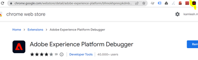

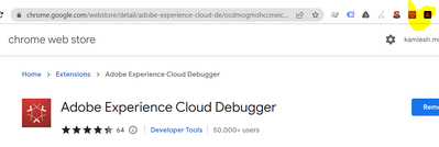

Dear All,
Adobe has 2 extensions as mentioned below:
  1. Adobe Experience Cloud Debugger https://chrome.google.com/webstore/detail/adobe-experience-cloud-de/ocdmogmohccmeicdhlhhgepeaijenapj
  2. Adobe Experience Platform Debugger https://chrome.google.com/webstore/detail/adobe-experience-platform/bfnnokhpnncpkdmbokanobigaccjkpob
Currently both the extensions are not clickable also not working. Could you please help.
