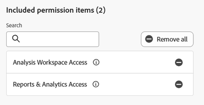

I am not sure, I don't see anything that looks like a permission specifically around "folders"...
My "non-admin" test account only has the following permissions:
Report Suite Permissions:
Analytics Tools:
And it has the right to create folders...
Maybe this is a temporary glitch? You could try logging out and back in again (all the controls are loading with JavaScript, so it's possible something just failed). There is some maintenance happening right now... maybe try again when it's complete?
