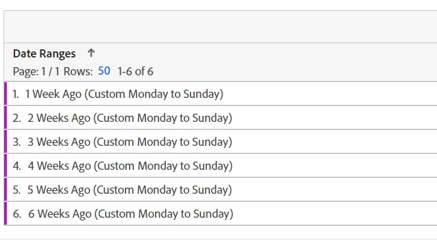

While the webinar will go into more details, you essentially have to create a series of custom rolling dates:
  • Custom 1 Week Ago (M-S)
  • Custom 2 Weeks Ago (M-S)
  • Custom 3 Weeks Ago (M-S)
  • etc
You can use whatever naming convention you want...
Then you don't break down by "Week", you actually need to pull in your custom date ranges:

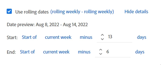

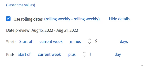

You create these using by using the standard week definitions, then applying math to shift the start and end dates:
1 Week Ago:
2 Weeks Ago:
You have to create as many custom date ranges as you need for your report (yeah, I know... it kind of sucks), but if you once you create them, they should be reusable components.
