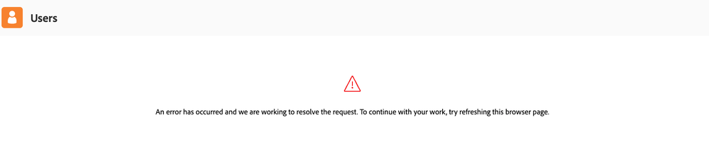

This is great! It worked in Preview. But after I saved this happened. Now I cannot see my User list. I also reset my cache. (I broke my instance!) lol0694X00000JuZNlQAN.png
What happens when you refresh the browser page, does the error go away? Likewise, can you navigate to another page or area in Workfront and then navigate back? Is that error still there?
So sorry this happened to you! It works perfectly fine in my personal instance. I'm hesitant to have you reset your user preferences, as that will reset your views, filters and groupings back to default settings and impact recents / custom tabs.
I'd recommend you contact Support to see if there is another option. I would try logging out and logging back in as well to see if the error resolved itself.
you can go into your /setup area to locate and delete your broken grouping and try again. We've all been there! :face_with_tears_of_joy:
