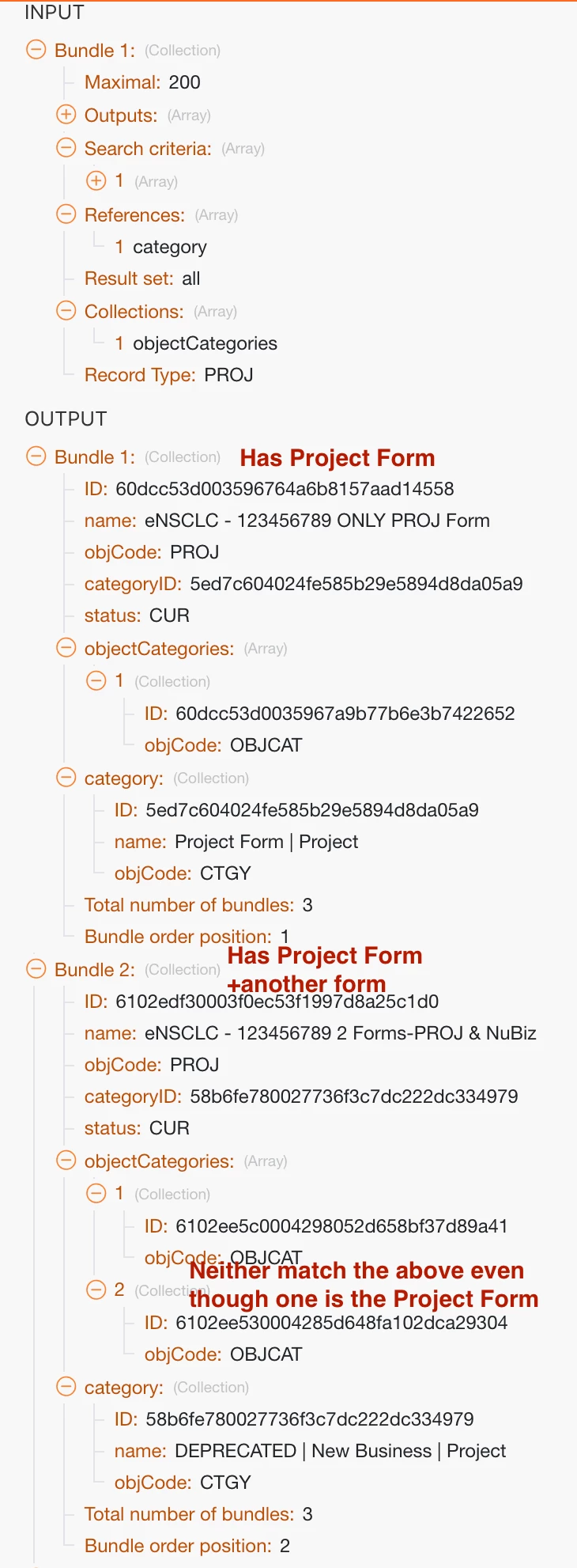

In the return bundle, everything makes sense except the objectCategories. There are 2 and neither are the form listed in the CategoryID section. In fact, I can't find these IDs anywhere. What are they, where did they come from? None of my forms of any kind have these IDs.0694X00000G823QQAR.pngI went and looked at the project and it has 2 forms. The form IDs are: 58b6fe780027736f3c7dc222dc334979 and 5ed7c604024fe585b29e5894d8da05a9, neither of which are in the objectCategories section.

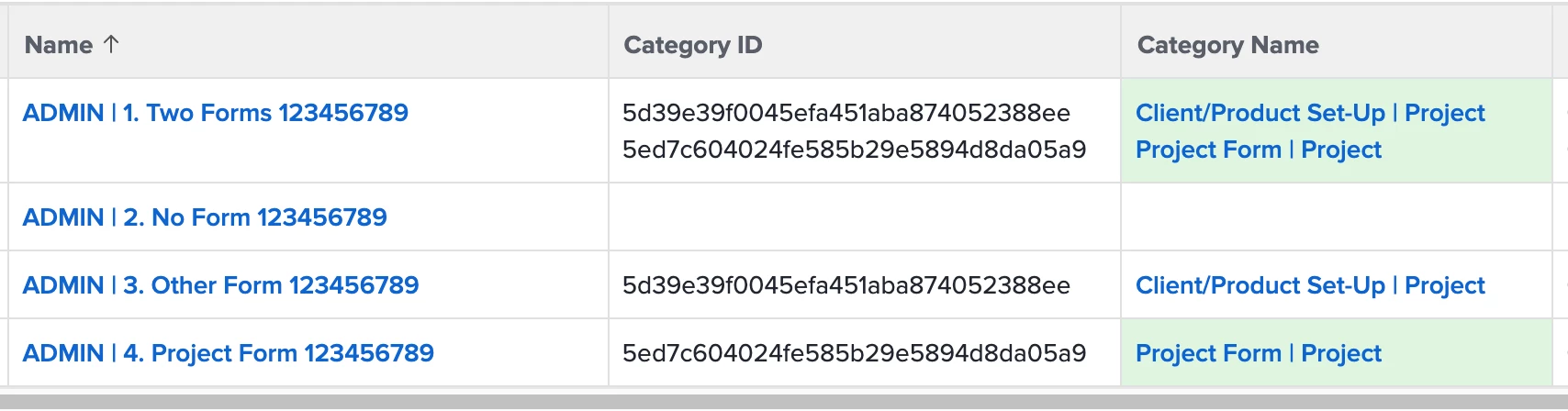

I created a project report with columns for name, Category ID, Category Name, objectCategories (ID), and objectCategories (category.name).
0694X00000G8294QAB.pngIf the objectCategory references the form, why do the IDs NOT match? Should I reference the Category ID or the objectCategory ID?
For example:
Is the ID of "Project Form | Project" 5ed7c604024fe585b29e5894d8da05a9 as in the Category ID?
or is it 6102ee5c0004298052d658bf37d89a41 as in the objectCategories?
This is pretty confusing.

according to the API explorer in the object category section, you should reference the object category's categoryID rather than its ID, if you plan to match it with a custom form ID. Are you able to do that and does it return better values (that actually match something you have)?
Hi Skye,
Good catch, unfortunately, I can't find a way to get that in Fusion.
I added a categoryObject.categoryID column to the report and it looks like it matches up. Thanks for that tip!
0694X00000G82yRQAR.pngSo I'm guessing I have to use the "objectCategories.ID" in Fusion and manually match it up with the "objectCategories.categoryID" in Workfront to know the name of the form I'm looking for when there are multiple forms in a collection.
That's WAAAY harder than it should be!
I'll need to look for 6102ee5c0004298052d658bf37d89a41 because that is the "objectCategories.ID" of the form that has the "categoryID" 5ed7c604024fe585b29e5894d8da05a9.
Which begs the question, Why more than one ID? Why make it so hard?
Scratch That idea, the objectCategories.ID of each bundle is different even if it's the same form I'm looking for.
Is there no way to get the ID of a project form when there are more than one? I need to find projects that do NOT have the form ID 5ed7c604024fe585b29e5894d8da05a9.

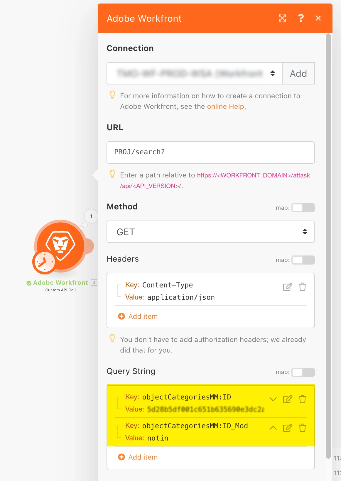

If you have your heart set on searching for "Form xyz not attached," the below custom API call module would return those records. The highlighted parameters could also be used as a filter between two other modules if you are working with a collection of records that was returned through some other method.

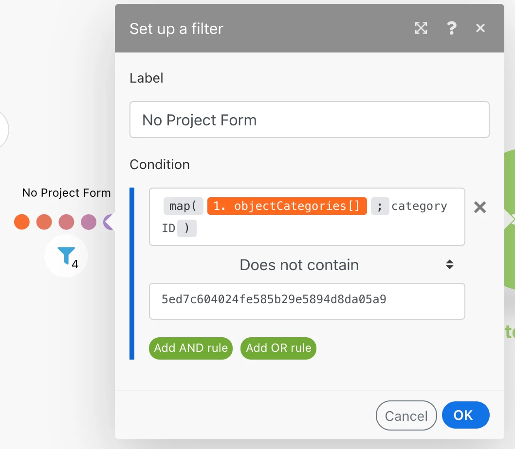

Thanks @Aaron Abbott‚ , this is great. It works but for one issue which I'm sure is because of something I chose incorrectly.
For the example, the "Project Form | Project" form is the one I want to add if it's missing (5ed7c604024fe585b29e5894d8da05a9)
I have 4 Test projects:
One with the Project form and another form, one with just the project form, one with just a different form, and one with no forms.
The problem is the one with the Project form and another form is passing through the filter and getting the project form added a second time. It doesn't mess anything up as the form info stays but it wastes time adding adding a form that's already there. Below are screen shots of what I interpreted your instructions to be:

0694X00000G88rCQAR.pngAs you can see below, bundle 1 is getting through the filter even though it has the correct form plus another form attached.
Can you see what I did wrong from this?

This one didn't work either. It should have blocked bundle 3 and 4 as they already had the Project Form 5ed7c604024fe585b29e5894d8da05a9
Level 6

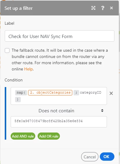

Two questions:
  1. Are you using the "Does not Contain" Text-operator (this is what we use) or the Array-operator?
  2. How do you call the objectCatgories? Via the collections? Here a screenshot how we call them
I think changing my collection search from "objectCategories:category:*" to the one you use, "objectCategories:*" did the trick! It's more data being pulled but it seems to work, Thanks!

You could also use objectCategories:categoryID to get the collection, this should also work.
