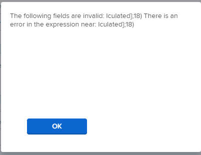

Has anyone used addMonths in a calculated field based on another date field?
Example: ADDMONTHS(Closing Date - Calculated;18)
When I add this expression to the custom form I get an error. I've tried the above example as well as wrapping the field name in {}.

Nichole. Thanks for your help. It’s all one field “closing date - calculated”. I tried wrapping it in {} since it has a dash in it. No luck.
sounds like Nichole was hinting you should use a comma rather than a semi colon?
Level 6
Skye. Also tried a comma. No luck. The Workfront documentation shows a semi colon‚Ķdoes seem like it should be a comma. In the expression I had comma didn’t work.
