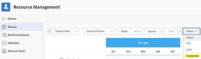

Since the recent Workfront update, my view for Workload Balancer has changed and there is new "BDG" column (which in my case is showing 0 for every role). Where can I find information on what this number is and how to input values so the data displayed is actually useful to me? Right now, the information I was getting from that view (to see variance between planned and available hours) is no longer showing up.
@DianaLe1 - based on the screenshot it looks like you are in the planner view and not in the Workload balancer
The BDG field is for budgeted hours. Budgeted Hours affect the value of the Budgeted Labor Cost (or the Resource Planner Budgeted Cost) of the project.

You can turn it off in your view if you don't use it by clicking on the 'Hours' dropdown and then customizing.
