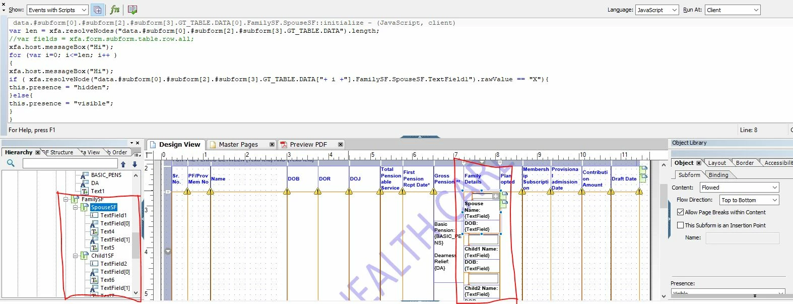

Hi Radsmar,
I am attaching you screenshot for better understanding:
Scenario is like this a column in table has multiple subforms, so for each record the particular subform should be visible if it has data.
otherwise it should be invisble.
Note: i have renamed subforms names and made necessary code changes as well for better understanding.
Revised Code:

Dear Radmar,
 i am attaching with screenshot for better understanding with hirarachy and code as well.
code:
 data.#subform[0].#subform[2].#subform[3].GT_TABLE.DATA[0].FamilySF.SpouseSF::initialize - (JavaScript, client)var len = xfa.resolveNodes("data.#subform[0].#subform[2].#subform[3].GT_TABLE.DATA").length;
//var fields = xfa.form.subform.table.row.all;xfa.host.messageBox("Hi");
for (var i=0; i<=len; i++ )
{xfa.host.messageBox("Hi");
if ( xfa.resolveNode("data.#subform[0].#subform[2].#subform[3].GT_TABLE.DATA["+ i +"].FamilySF.SpouseSF.TextField1").rawValue == "X"){this.presence = "hidden";
}else{this.presence = "visible";

So, you want to hide subform "SpouseSF" if the field "Textfield1" is empty?
I have a couple of questions about that:
1. Where does the data come from for "Textfield1"?
2. What's the loop for?
Siva407Author
May 6, 2020
1. Textfield1 I am filling it interface, it's actually flag I am setting it with "X" to hide subform
radzmar
radzmarAccepted solution
May 7, 2020
Well, you can simply use this JavaScript in the calculate event of SpouseSF.
this.presence = Textfield1.rawValue == "X" ? "visible" : "hidden";

May 11, 2020
it worked... thanks a lot...
