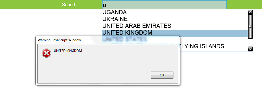

Hi Bibhu,

Your example works fine. But there is a problem. It's not taking the space. For example :
There are 3 choices in the dropdown.
Say : abc
         ABC
         Abc 123
When I type 'a' then it lists all the choices without any problem. The moment I type 'abc' and hit the space bar all choices vanishes. Could you please tell how to include this functionality ? So that when the user hits the space bar after typing few characters those corresponding choices which has a space inbetween must be displayed?

Hello Bruce,
What I was trying to say is : If you type New then both the countries New Zealand and New Caledonia are displayed. The moment you hit the space bar after typing the New then the dropdown suggest box goes blank. I want if you type some letter and after that we hit the space bar all those names containing that letter should be displayed , like that of a FaceBook/ Google search.
Thanks.
Bibhu.
_Bruce_Robertson
December 21, 2010
Hi Bibhu,
I am not seeing this behavior, if I type the space after "New" then the two countries stay in the list. I have tested this code in versions of Reader 7.0.9 to X so I'm not sure what to suggest. What version are you using.

Hello Bruce,
There is a problem. The search results are only shown by the starting letter.
For Example : There are 3 Dropdowns.
                       Chistmas
                       Happy Christmas.
                       Happy Chrismas to you all.
If I type Christmas then it should show all the 3 entries. But it's showing only the starting Christmas. (This is only for the example purpose, the same situation is applicable to the Countries as well.)
Thanks.
Bibhu.
_Bruce_Robertson
December 24, 2010
Hi Bibhu,
You could change the sample to work in this way by replacing the line populating the list in the Search text fields change event from
list = xfa.resolveNodes('$record.country.[Lower(Left(name,' + (xfa.event.newText.length) + ')) == "' + xfa.event.newText.toLowerCase() + '"]');
to
list = xfa.resolveNodes('$record.country.[At(Lower(name),Lower("'+xfa.event.newText+'")) > 0]');
Bruce
