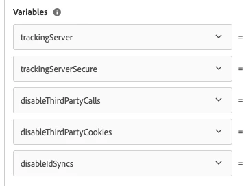

What is the best way to control the firing of AAM in adobe launch? Cookies like demdex and Everest are dropped by Adobe audience manager which we want to make sure are only dropped when the user has only consented for advertising cookies. We are individually approving all the extensions in the Opt in services code. However, AAM is firing even when it is not approved, inconsistently seen to fire alone by ECID approval, unless the disabled parameters are set in the ECID extension (Screenshot attached). We don't want to use the patch work of adding disabled variables as it has a trade off in other area. Any thoughts/ideas would be highly appreciated. Thank you! 

I think what you're seeing -- cookies being set -- is not because of AAM, but ECID. See https://experienceleague.adobe.com/docs/id-service/using/intro/cookies.html?lang=en and https://experienceleague.adobe.com/docs/id-service/using/intro/id-request.html?lang=en. These detail how cookies are set/used by ECID, in particular, to identify visitors consistently when used across domains.
To check if ECID is really the culprit, try unselecting its Pre Opt in approval as well.

Thank you! That was helpful. I see demdex cookie is unrelated to AAM. Although, I couldn't read a lot about the disable variables within ECID extension, why and when to use them and trade-offs.
It was our intention to stop using them and we are only using it to prevent AAMs from firing in functional consent. What other options are there to stop AAM from firing? I have used Optin service and denied AAM specifically in the respective rule but that did not help as ECID alone is able to fire AAM. Looking forward to hearing your thoughts. Thanks!

@pallavig You can use disableThirdPartyCookies functions to not set demdex cookie on your browser by ECID service, in a you are hiding the demdex call, which is used to create the MID
https://experienceleague.adobe.com/docs/id-service/using/id-service-api/configurations/disable-cookies.html?lang=en
