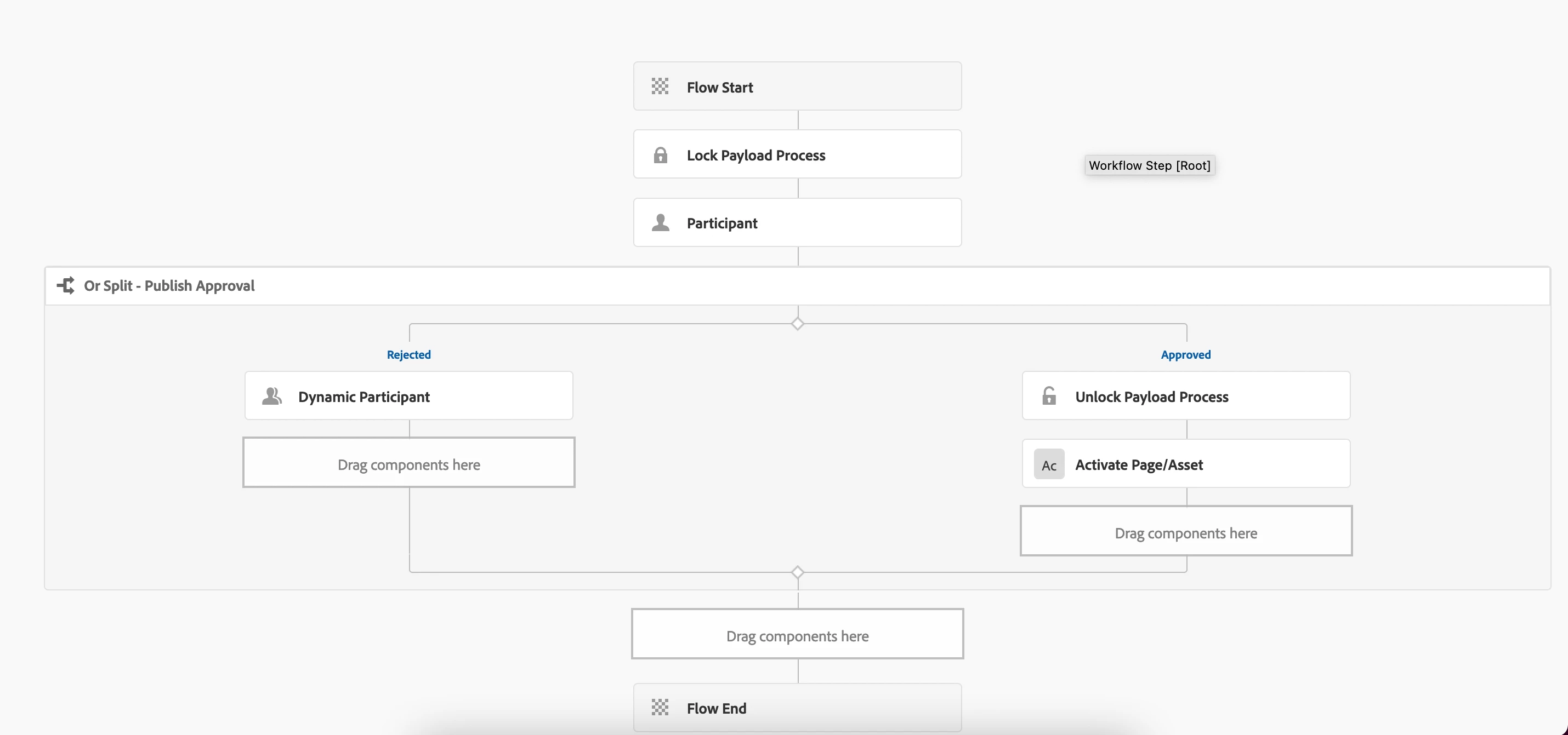

I have requirement by default page lock whenever page publish it should be unlocked to the particular author for review once accepted then it will be published page and if it is rejected then it will return back to the author and locked the page.also we can able to scheduled time as well where we can add the time when it will be published.
Does anyone worked on such type of requirement?
Best answer by sunil_kumar_
@bangar20
This just a high level solution not exactly to your use case. But it will help to design your solution.
1. As soon workflow trigger. It will lock page.
2. You can use any Participant Chooser as per need. There are others which may be used for your need. You can have this before lock as per need.
3. Assigned reviewer can choose next step or you can write custom logic to move to next step as per your need.
4. Left Branch -  If rejected. Assign this to workflow initiator(You can use ECMA script to get Workflow initiator)
5. Right Branch - If approved,
          -> Reviewer can schedule publish. In this case activate step not required.
          ->You can write custom step, If this has to be done in workflow only(If don't want to use OOTB publish schedule)
         -> Unlock Page
I hope this will help. Again, This is not the exact solution to your use case. But a high level solution as per how much I understood.

sunil_kumar_
May 29, 2022
Please provide some information to understand your scenario properly.
1. How will you trigger this workflow. Will this trigger on page publish. If yes, then you must disable OOTB publish workflow.
2. How will you select Author/Reviewer. Is it based on content hierarchy or manually.
3. If it is Rejected, Whom it should go back. ie. the user who initiated publish.
4. How will you scheduled time to publish. At what stage, you will schedule time. ie. At starting the workflow or assigned Reviewer will schedule time while reviewing it, If it is not rejected.
I can try to design workflow after having this information.
bangar20Author
May 30, 2022
Hi @sunil_kumar_ ,
1.Yes while page selection start the workflow manually.
2.if it is rejected then it return back to author who start the workflow.
3.after reviewer accepted unlock the page and he can schedule time for publishing.
sunil_kumar_
sunil_kumar_Accepted solution
May 30, 2022
@bangar20
         -> Unlock Page
ECMA script function to get workflow initiator
function getParticipant() {
    return workItem.getWorkflow().getInitiator();
