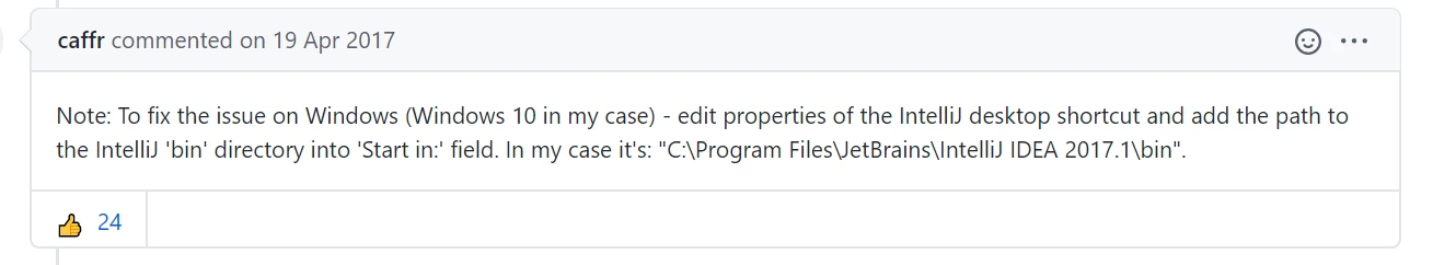

and try this below sol. It seems this has solved the problem for many.

See this https://github.com/shsteimer/IntelliVault/issues/3,it is suggested to not put the bin in your vault path.
I.E. use c:\filevault in the vault path setting not c:\filevault\bin

@vanegi This is not correct as application should always point to your /bin path. FYI, this is something which was working earlier and is not working now after upgrading to 2020.1 which is a product bug.
