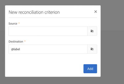

The issue is that I cannot select the filename as a source for the join.
It only has fields available from inside the CSV file. Is there a way to make the filename available as a field?
you could define a new field using the enrichment and set it to
$(vars/@filename
Then you could use there
