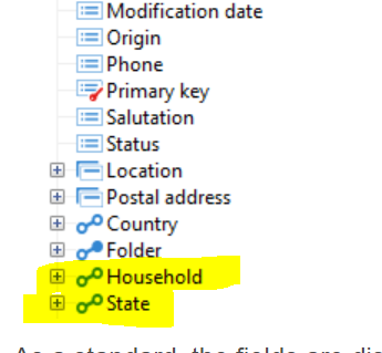

The recipient table has a foreign key of my table(XYZ) and shows connected in the structure just like the link that you can see for the folder in the below picture.

I added other fields in the form from the below list and mapped it to respective fields, which are highlighted below:
After the above process, I configured the list the data is showing fine for these.
The issue happens every time I try to add a field related to my table or the folder highlighted in the first snapshot and both the icons shows that they are related in the same way.

The column you're adding to your view is causing the view to perform an inner join against a table that doesn't have data in it.
In your web app you need to write this data, alongside the captured recipient data.
