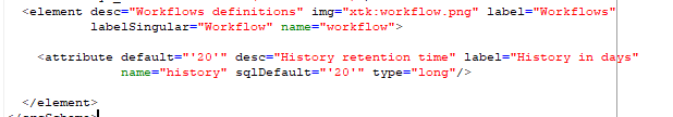

Hi, davidk23955130
I want my "history" attributes default value as "20" in xtk:workflow. so i extended that schema, and gave the attribute as you mentioned above.
(Note: while i tried to update database structure, i didn't found anything to update there.)

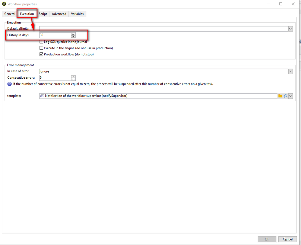

Then i disconnected and reconnected.
Then i created a dummy workflow and i found the history of that newly created workflow as "30" and not "20" in xtk:workflow data.
So This doesn't worked for this case. Please help me with this!
Thanks and Regards,
Partha.
Hi Partha,
you're trying to set up a default value to 20 while your workflows templates are set up to 30.
David
